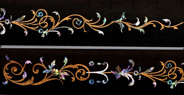

Why couldn't you get intricate? Larry Davis sells resin impregnated woods (including Koa) that stuff will wear like the kitchen sink. I think it would look great.
PostPosted: Tue May 16, 2006 12:20 pm
In fact, seems like I saw a photo recently of some artist using koa for the "vines" on the vine fretboard inlays. Can't remember where I saw it, but it was incredible.
Also, remember that Taylor guitars has used wood lots on their fretboard inlays: running horses, the John Denver model, etc.
PostPosted: Tue May 16, 2006 1:09 pm
It was Paul Bordeaux. He posted them here.

Hi Guys,
Here's a copy of the photo originally posted. Thanks for the kind words.
Paul Bordeaux

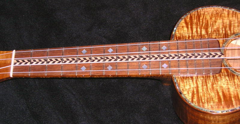

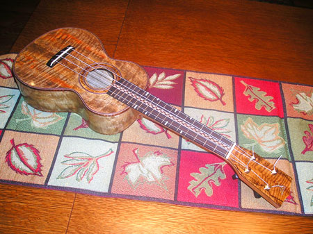

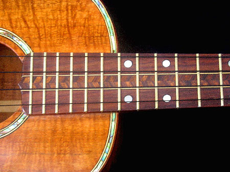

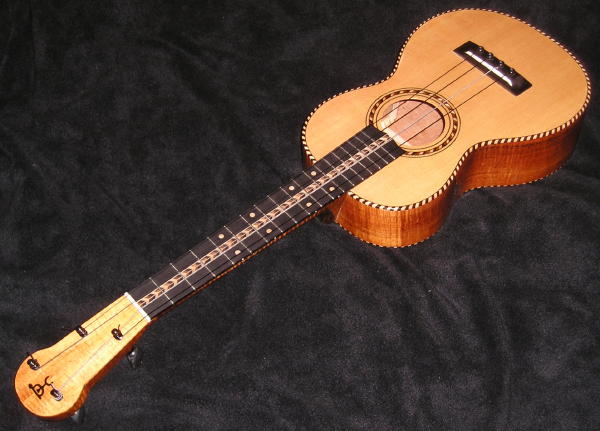

Here are some pictures of ukuleles from Dave Means that use a center wood inlay in a rope pattern. I happen to like the look and plan to use it in a future project.
Philip
aka konacat
